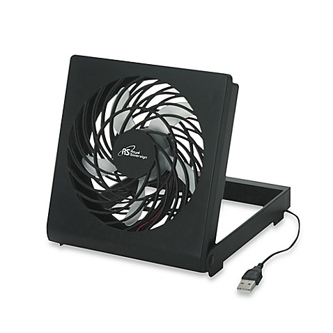

USB FAN it =)

Thanks for posting that tip as indeed it is a good on for readers here to see. I do already use one though for the past year xbmcdoc so know their benefits in hot places like here. I got hold of a quite small one that is more in size to fit under my ATV1200 box and cost me about 200 Thai Baht (£4). The ATV520 box though is very much smaller than the ATV1200 so I doubt I could find a suitable USB fan small enough to be practical. But I mainly use my ATV1200 as it is a superior box that also supports WiFi with Gotham and Helix of course.

Interesting enough pushing cooler air from under the box is more efficient than fanning from the top. The ATV1200 has a fan plug inside too. I think it is a 2-pin plug. I tried a little fan inside the box once but it was loud and didn't have time to install a switch in between (turn it on only when needed).
