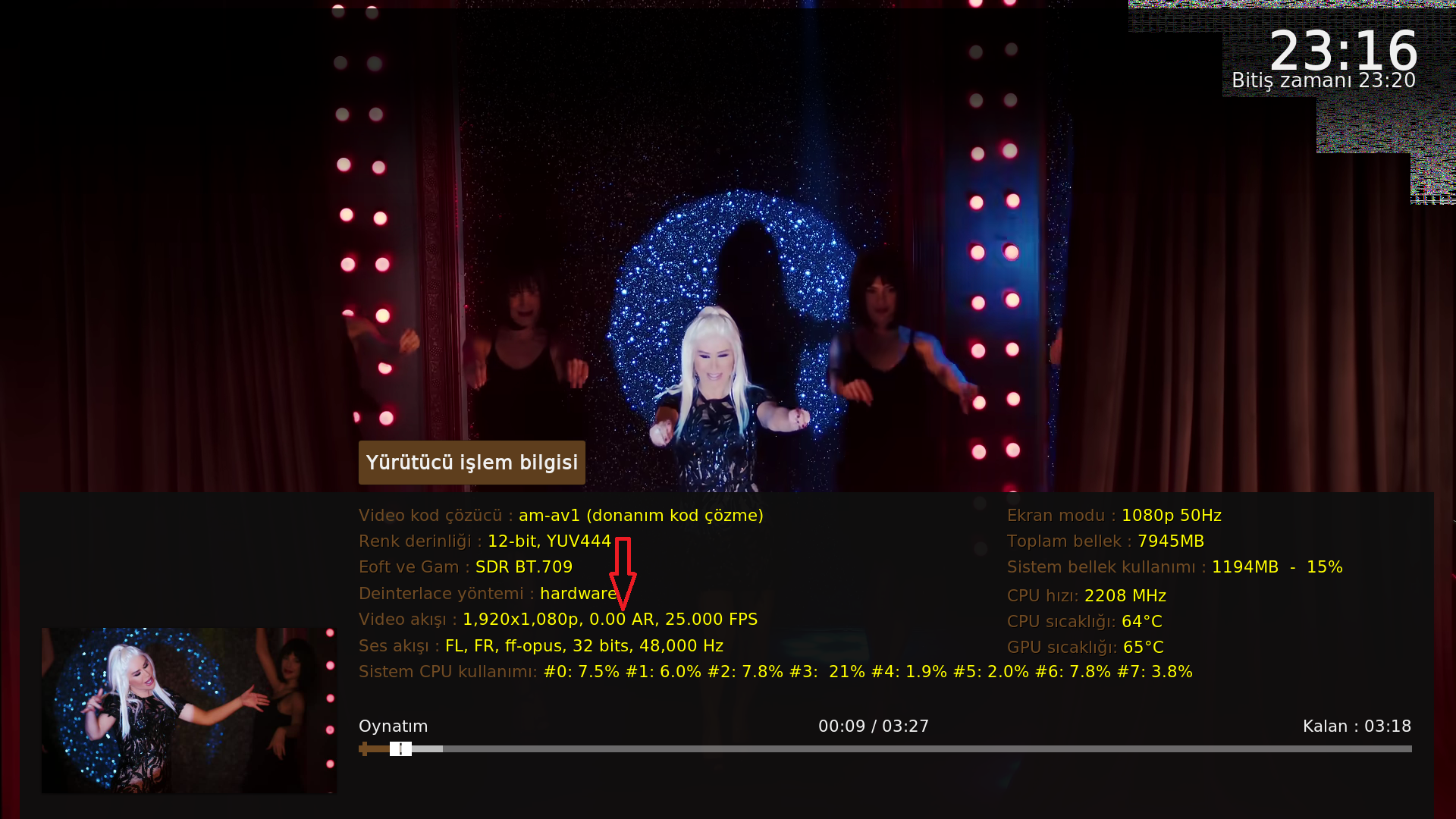

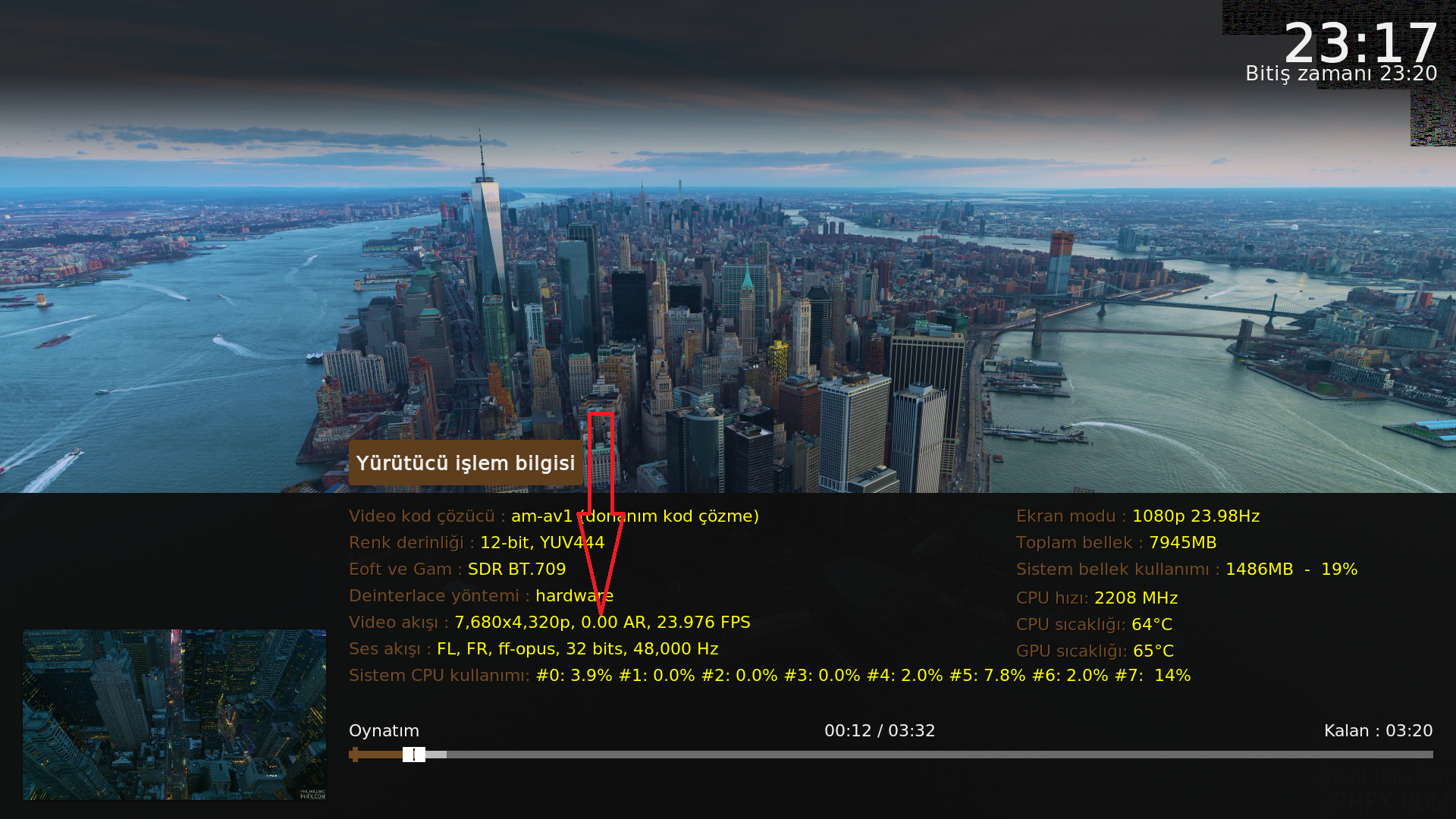

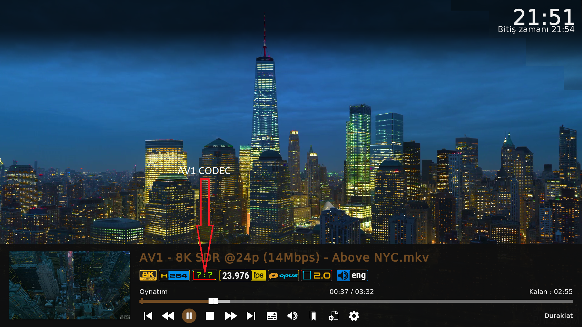

Could it be icons about AV1 codec?
Not sure. You've pointed to aspect ratio, not to codec (shows H.264). If you could provide a link to a 8K AV1 snippet I could do some investigations. But wow, 8K occures very rare

crazyturk As seen in both screenshots kodi itself cannot determine the correct aspect ratio (it is always 0.0). So it's not possible to show the right flag for it.
Same the wrongly detected codec (H.264 instead of AV1) - even if kodi shows the correct video codec in process info (am_av1)
Ok, the plain estuary shows the right codec flag - so it's possible to implement this one into modv2.

Video flag with av1 codec updated. Available on next update.
