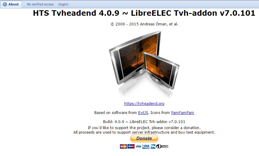

- Take the IP address of your htpc and pop it into your computers web browser with the port number 9981 so in my case it is:
http://192.168.1.123:9981
You should now see the TVheadend web interface. If you click about you should see the details of your PVR server version that is running. Congratulations, it works! We're most of the way there.
