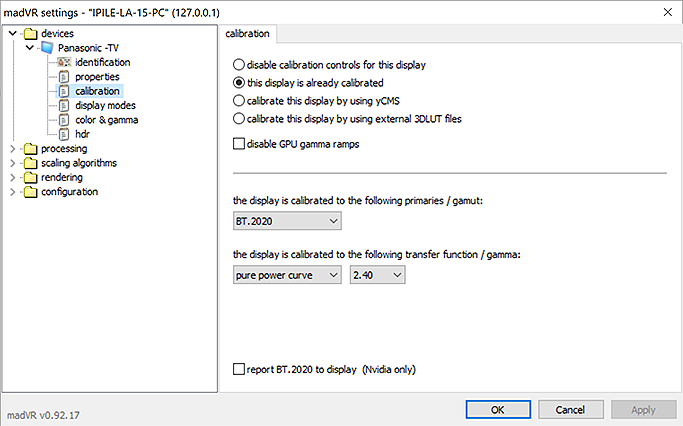

There are two settings in madVR that require adjustment with this video:
  • transfer function / gamma;
  • real display peak nits.
devices -> calibration -> this display is already calibrated:
Note: This black clipping video is very short, so consider pausing it while making any control panel adjustments.
The example above shows what happens when the wrong gamma curve is used. Most of the bars past Bar 64 are completely black that means shadow detail is being badly crushed.
If enable gamma processing is not selected in the control panel, the gamma setting in calibration only applies when HDR is converted to SDR. So you may have been unaware of any gamma-related issues when using madVR until you attempted to playback HDR sources. Accurate display gamma mapping is most critical for preserving near black shadow detail.
Most displays will be calibrated to either 2.20 or 2.40. If your display hasn't undergone a full grayscale calibration with a colorimeter and appropriate test patterns, its gamma tracking could be slightly off, or way off the gamma set in its picture options like the example Samsung LED below. Finding a detailed review for your display online is not a bad idea to reference its expected factory-calibrated SDR gamma accuracy.
