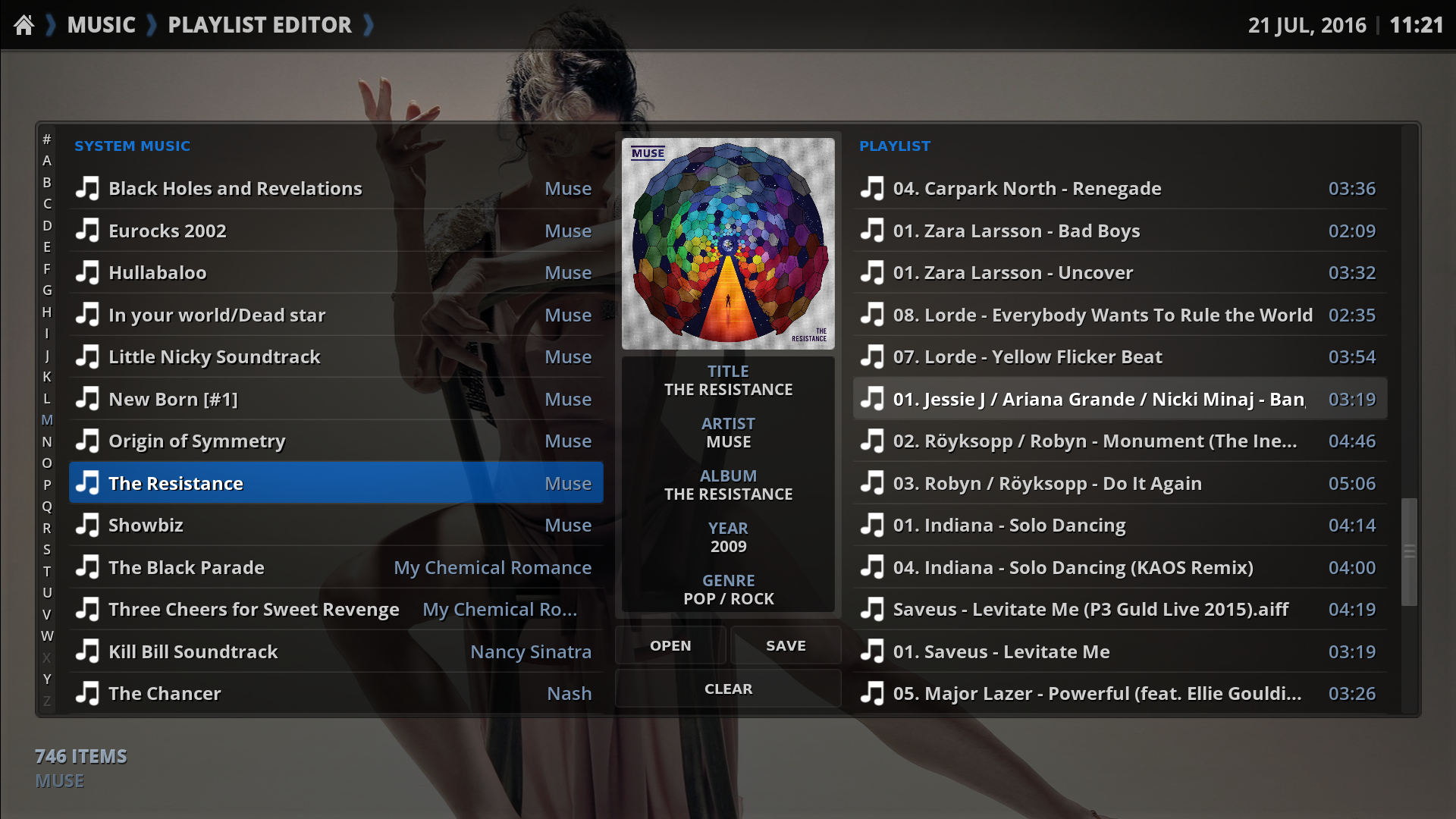

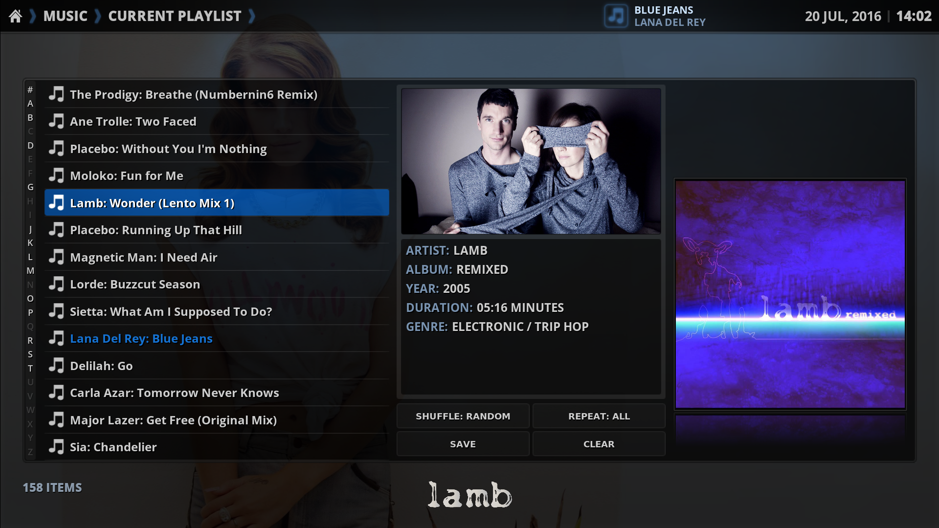

UPDATE: Rapier 9.5.11 is available through the official Kodi repository!
This update is installed automatically.
If this is not the case, you can download it here.
The highlights are:
  • Extended View has been added for movie, tv show and music video tags.
  • Playlist View has been created to extend information and user friendliness in current playlist window. Screenshots below.
  • Playlist Editor window has been updated. Screenshot below.
FULL CHANGELOG
9.5.11 (26-July-16)
- Code cleanup.
- Added more animations to "Low CPU Power Mode".
- Updated playlist windows: changed shuffle button, added info labels and media flags.
- Added Playlist View to current playlist window.
- Updated playlist editor window.
- Added Extended View to movie, tv show and music video tags.
- Added season number breadcrumb to episode window.
- Updated main category languages (thanks to patria o muerte, rootsun, NEOhidra).
- Updated favourites dialog.
- Updated README and merged README.txt into README.md
- Added weather add-on settings button to weather window settings dialog.
- Bugfixing of add-on browser breadcrumbs.
Music
Video
ENJOY!
