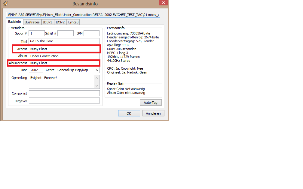

I have mp3 file tagged as follows;
As you can see the Album Artist tag is no filled, according to the above ->
Quote:If no Album Artist tag exists, XBMC will use the first (primary) artist from the tracks as the Album Artist.
Well thats not true, the above album isn't recognized at all...?

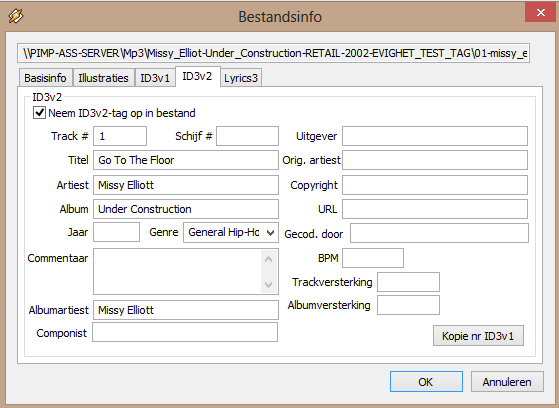

If I load it up in winamp and re-tag it
It all works fine.
Why isn't xbmc combing artist field and album field?

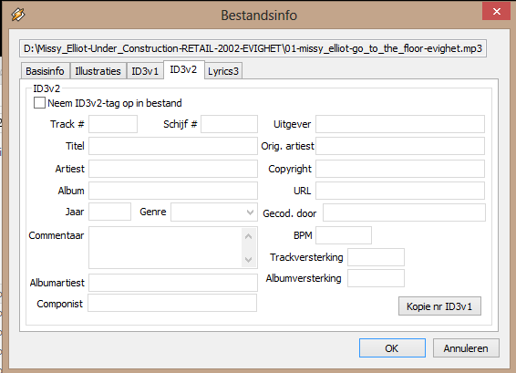

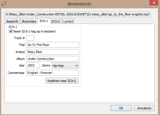

Wel I used many nightlies but this hasnt been fixed, I am still missing id3 v1 only tagged mp3s. Thousends in my case. Could I help in anyway providing files and test results?
(2013-01-24, 23:04)menno Wrote: Wel I used many nightlies but this hasnt been fixed, I am still missing id3 v1 only tagged mp3s. Thousends in my case. Could I help in anyway providing files and test results?
Yes
Read/follow the forum rules.
For troubleshooting and bug reporting, read this first
Interested in seeing some YouTube videos about Kodi? Go here and subscribe
ID3v1 files were never read prior to when I implemented it shortly after RC3.
You'll need to supply a file in order for it to be tested by someone else. It would massively speed up the process, however, if you tested a build from last night beforehand.

I sent files to marshall but never heard back, 15k songs out of my 34k collection are not recognized due to faulty id3v1 implementation (all eden and bedore worked well). Could someone please look at this major bug?
Is someone ever gonna look into thisHuh I cannot see why nobody complains about this, but this way I am forced to search for addons and maybe subsonic like solutions to be able to play all my music from within xbmc!!! proper id3v1 support please like EDEN had.... I am over 15k songs short!
