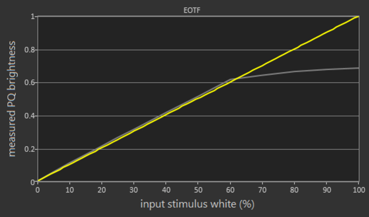

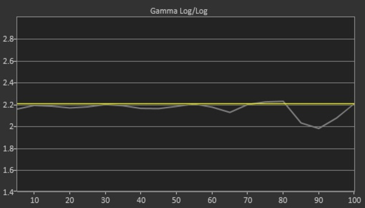

Gamma and EOTF Tracking
Gamma or EOTF (Electro-Optical Transfer Function) accuracy has an equally large impact on image quality. Gamma and grayscale are typically calibrated with the same set of controls. EOTF tracking indicates the ability of the display to produce the precise amount of luminance (Y) at each point of the grayscale. If each brightness point has the exact amount of luminance as specified by the reference EOTF formula, the resulting color will be neither too bright nor too dark. This will lead to ideal color saturation for each luminance level and a more three-dimensional image, as dark detail is not crushed and white detail is not blown out — ideal dynamic range and contrast is created.
EOTF accuracy is measured by calculating deviations from the target formula at different intervals of luminance. Deviations are expressed as the averaged gamma reading or as luminance errors.
Relevant Controls: 10 to 20-point grayscale; Backlight/Iris; multi-point gamma (rare).
Impact on Image Quality: Color saturation; Black levels; White levels; Image depth.
Calibration Target: average = target gamma, or minimum luminance errors PQ EOTF.

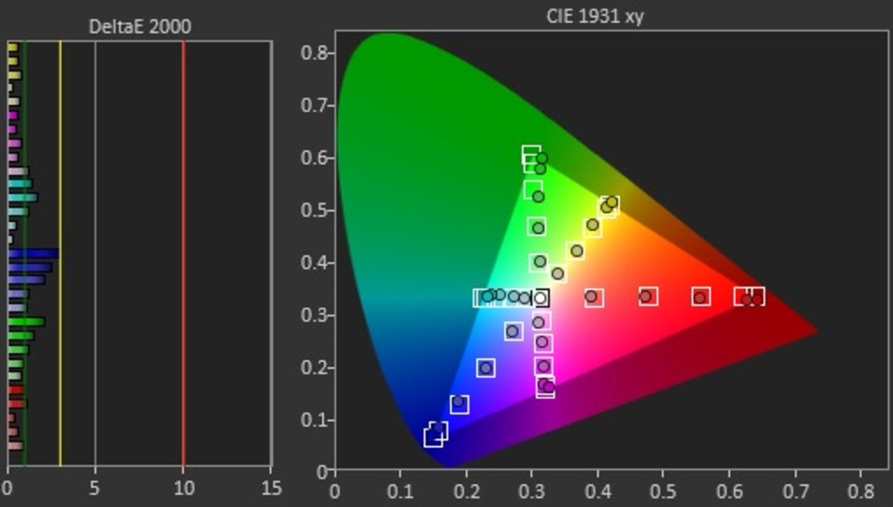

Color Accuracy
The final calibration step measures the accuracy of the entire gamut. All six primary and secondary colors are evaluated: red, green, blue, cyan, magenta and yellow. The perimeter of the reference gamut is formed by red, green and blue. An accurate grayscale can help align the secondary colors but cannot help with a display that is undersaturated or oversaturated for the primary colors.
Colors are measured at 100% saturation. A saturation sweep is made at different intervals (typically, 20%) and points are plotted on the color chart. A display with an accurate gamut will line up each point within the target square. This test measures both absolute color accuracy and accuracy across different levels of luminance. The combined result of each gamut slice is calculated as an average Delta E for all colors. Displays with the same Delta E may misrepresent a color in different ways (e.g., one red is too orange, and the other too pink). This color chart tends to be the greatest stress test for the accuracy of the display.
The tint control on a display will rotate the gamut around the white point. While the color control increases or decreases the size of the overall gamut. Displays equipped with a Color Management System (CMS) will have independent controls for each of the primary and secondary colors.
Relevant Controls: Color; Tint; Grayscale; CMS: Color Management System.
Impact on Image Quality: Color saturation; Hue accuracy.
Calibration Target: 100% BT.709 or 100% DCI-P3, Delta E < 1.

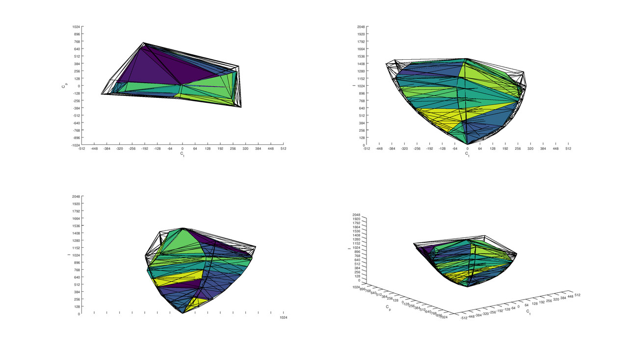

Gamut Volume
The combination of display brightness and gamut size represent the overall gamut volume of the display. This measures the display’s ability to render all colors within a given color space, but it is not a measure of color accuracy within that space. HDR displays with a large gamut volume will best be able to render bright and saturated colors for HDR content.
Good Value (normalized): BT.709 100%; DCI-P3 95%; BT.2020 78%.
Good Value (compared to a reference 10,000 nits HDR monitor): DCI-P3 55%; BT.2020 45%.

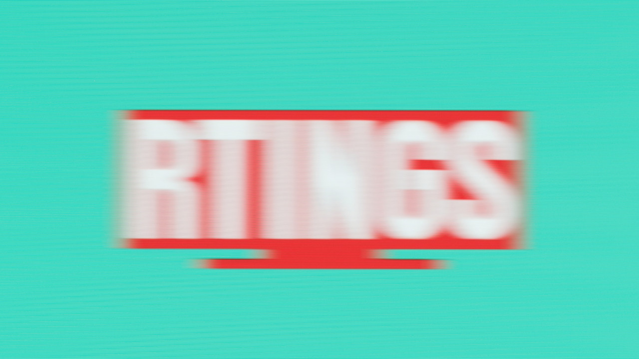

Motion – Response Time
Motion has nothing to do with color accuracy, but it does relate to display accuracy. If you want good motion, you want a display with a low response time. This tracks the amount of time required for the display to change from one color shade to another. The lower the response time, the less motion blur is created with moving objects.
Good Value: 0.2ms - 10ms
Motion judder should not be a concern with modern displays. Today’s panels can remove 24p judder from almost any source:
