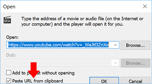

Playing HDR Demos from YouTube
If you are looking for high-quality HDR demo clips, YouTube has a growing catalogue of free 4K UHD HDR content.
This content can be easily played with MPC-BE by opening the URL address for any 4K UHD HDR video with the media player.
Instructions
Open YouTube in a web browser and navigate to the channel with 4K UHD HDR videos you want to play:
Select a video and highlight the URL in the address bar. Right-click and select Copy:
Open MPC-BE and navigate to the Options menu. Under Online media services, configure the player to play 4K UHD HDR streams by checking the options below:
Select File -> Open File/URL…
Check Paste URL from clipboard and the copied link address will be automatically loaded. Press OK to play the video:
You can confirm the stream is playing in HDR with the madVR OSD (Ctrl + J).
