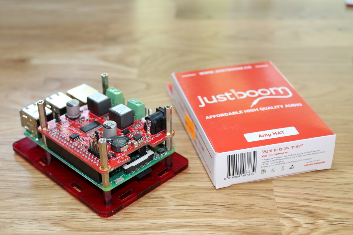

Amplification
At first I tried building this system with a custom wall mounted amplifier but it had a few disadvantages, it was expense at first at over £100 and had way too many LEDs lit up. I also had to turn it on and off when needed which was annoying and was not easy to use. I started looking at custom Raspberry PI breakout boards and found the Justboom "Amp HAT" as the ideal solution. Not only did it have an amplifier built in, but it also contained an onboard DAC which basically makes your music sound much better! You can use this device with any set of passive(unpowered) speakers without any other equipment. I tested it and the music does indeed sound much fuller with a wider range. Pretty impressive! One of the big advantages of the Justboom was that it fits onto the Raspi with a simple click with no soldering required. The AMP HAT is powered by a custom power supply but this also powers the Raspi so only one plug socket is needed. All in all I found this a great bit of kit, if a little expensive at £60. The only real disadvantage I found was it needed a custom case.
The case
I bought the custom JustBoom laser cut red acrylic case (they do a black one too). It works as expected and provides the PI with a nice enclosure with all the ports needed available on each side of the device. The only disadvantage of this I found is you have to take the top of the case off to attach the speaker cables.
