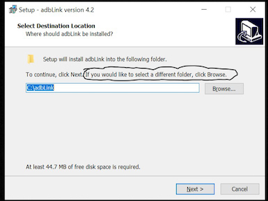

Unfortunately, upon opening the .exe, I'm not presented with the option to select any directory (obviously, were I, I would not have made such a request Wink). The process merely begins and updates automatically. These are the two installation screens that appear before the installation begins:
Is there a way to force it?

(2019-07-14, 21:58)Txxb161 Wrote:
(2019-07-14, 21:40)jocala Wrote:
(2019-07-14, 20:49)Txxb161 Wrote: Thanks for staying on top of the oh-so-useful app. Curious as to what necessitated the move back to an unsecured site? Also, would it be possible with some future release to add the option to choose the installation/update directory? ADBLink has been forcing itself to update/install in a directory I deleted many versions ago, which requires me to manually copy/move files after the installation/update has completed. Thanks again!
You can navigate to a new installation folder by clicking the browse button, or you can overtype the "c:\adbLink" with your selection and it will be created.
Free https certificates (letsencrypt, etc) weren't working out for my purposes.
Try this build...

Thanks, but I was able to fix it using regedit and deleting the extraneous uninstall references that were pointing to the long-ago previously deleted directory. I am now presented with a directory installation option.
