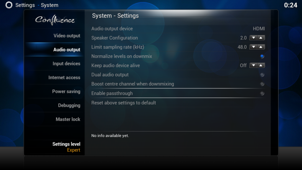

Here are my audio settings for reference:
and I also have Volume Amplification set to 30db.
