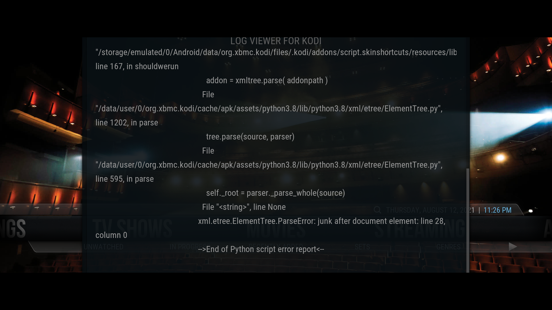

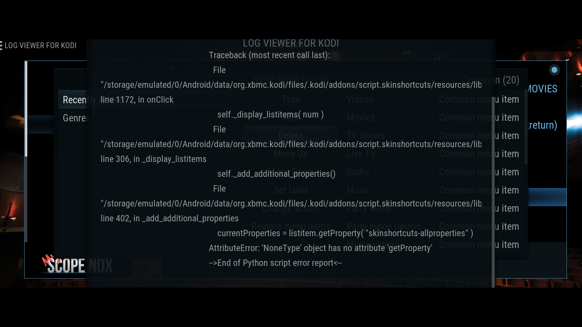

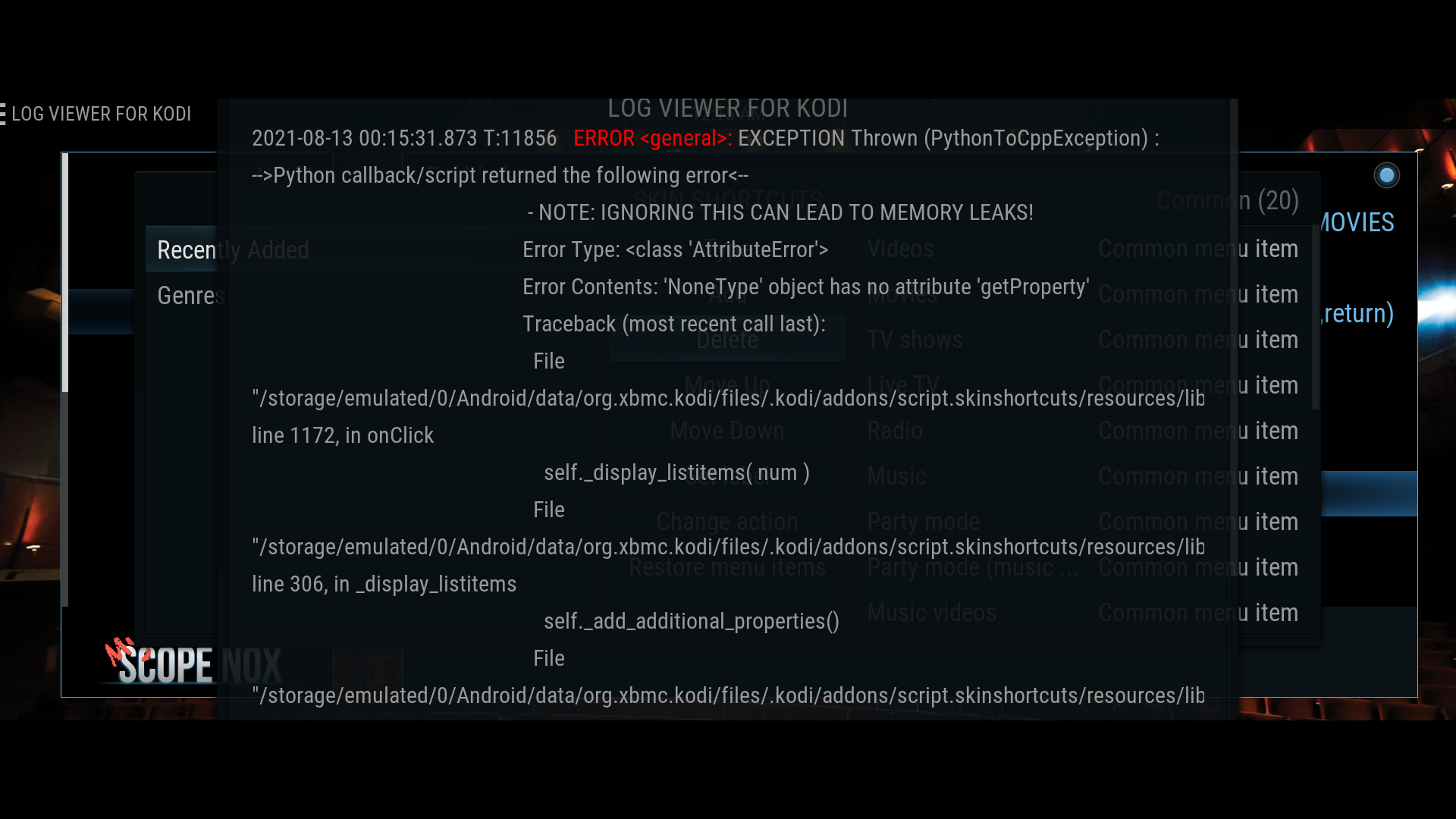

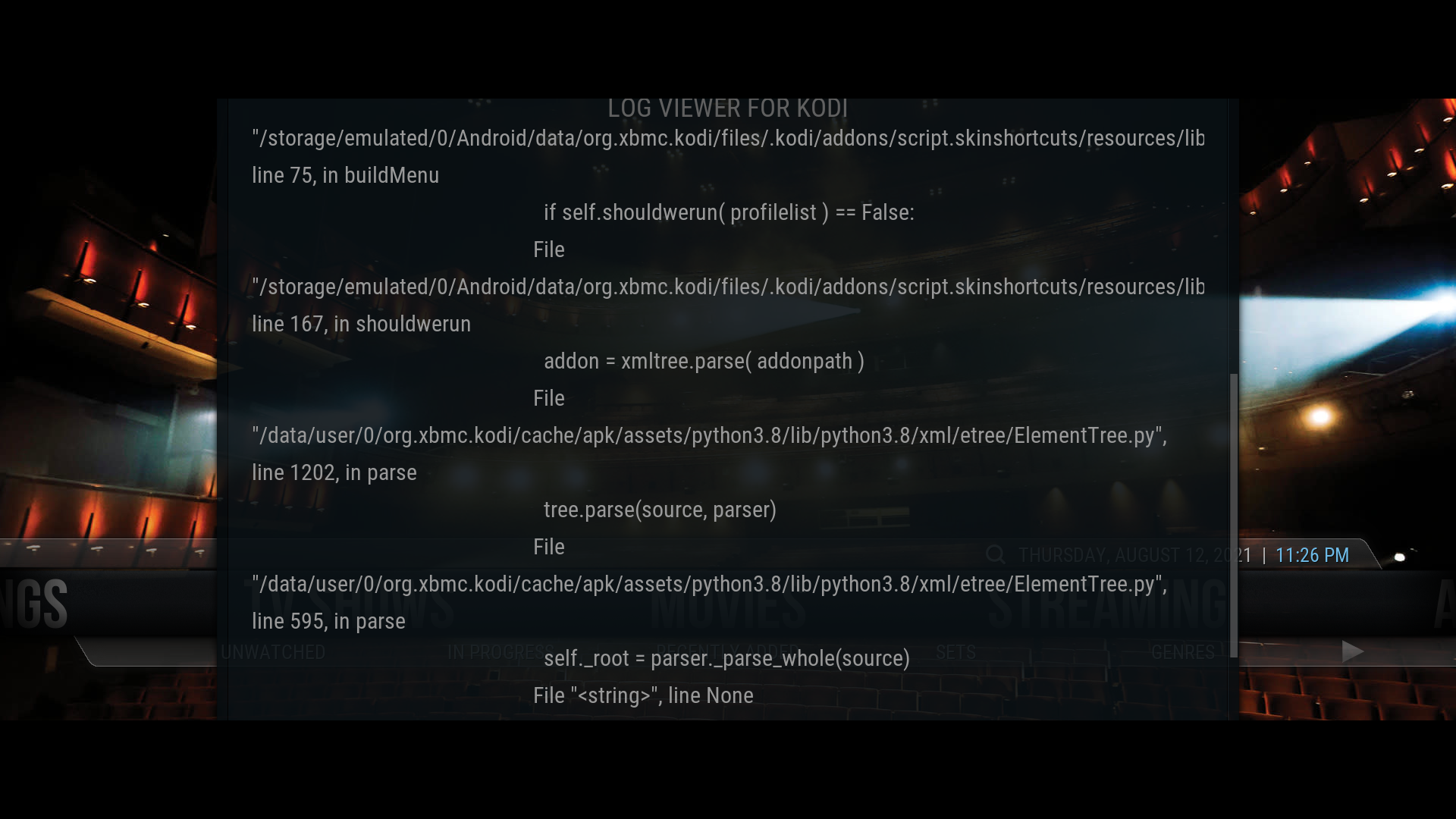

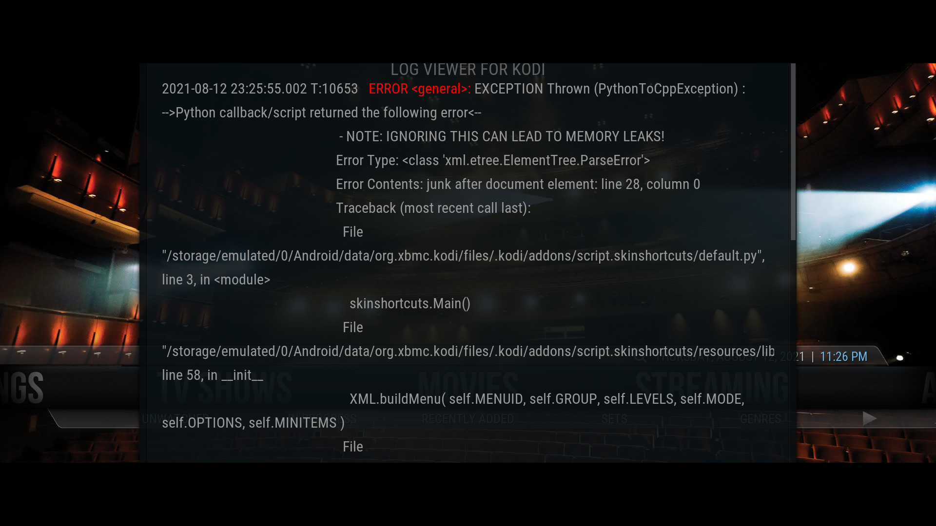

Firstly, it looks beautiful!  It seems that your ScopeNox is MyScopeNox Wink  It looks so fresh and polished.  Best skin ever!
However, this version does not like my submenus.  I got the below error immediately after updating the skin.  I played around with it for a bit in the submenus and when I delete "Tag" from the Movies menu I get the second error.  That was all the testing I had time to do last night.
I hope my posting the error is helpful.
The update also wiped out my customized submenus except for the "SETTINGS" submenu.

I noticed this too and was mostly ignoring it up till now because things seemed to be working still and I waned to get through all the video views.  It happened between 1.4.1 and 1.4.2 and there were quite a few changes done in this timeframe but so far I've been unable to find the change that broke this.  I'll keep looking, I'm sure I'll find it eventually.  You will see 1.4.3 in Github, I don't recommend trying that.

Spent half the day tearing apart all the files that were changed trying the figure out how and where I messed this up.  Turns out it was a fat finger typo in a very unexpected place and will be fixed with the next build.  In the meantime you can correct this on your end by removing extraneous last line/character from addon.xml

(2021-08-14, 16:23)pfp-az Wrote: Spent half the day tearing apart all the files that were changed trying the figure out how and where I messed this up.  Turns out it was a fat finger typo in a very unexpected place and will be fixed with the next build.  In the meantime you can correct this on your end by removing extraneous last line/character from addon.xml
OMFG LMAO... "_"  I'm so sorry  Oo
Works great now!
